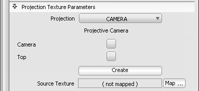

  1. Set Projection to CAMERA. The Projection Texture Parameters window expands, listing all cameras that have an image plane. (You can only use the CAMERA projection method for cameras that have an image plane.)
  2. Click the Projective Camera toggle box for the camera you want to create a Projection texture for.
  3. Click the Create button. A Stencil texture representing the image plane is automatically mapped to Source Texture.
