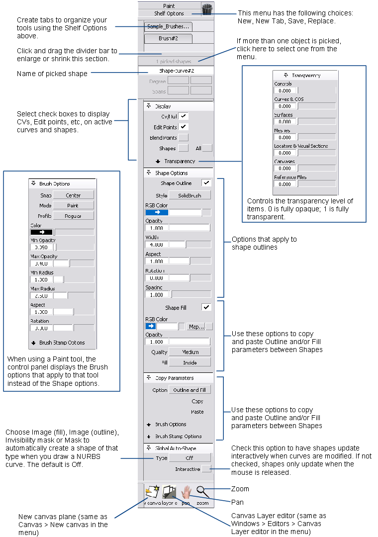

Paint control panel
The shelf area
The shelf area contains shelf sets, which are sets of tools you can customize to help with your workflow. You can change the contents and number of shelf sets in this area, and compress them or expand them by clicking the tabs.
This area also lets you have more window real estate by offering a compact alternative to the main shelf window. For example, you can put all the symmetry tools in the shelf set area and then close the main shelf window for a larger view of your model.
Click the Shelf Options tab for a drop-down menu that lets you add, save, clear, and replace shelf sets in the shelf area.
Shelf Options

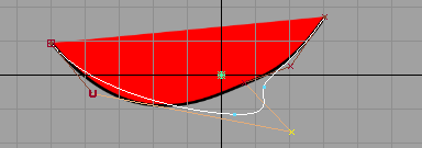

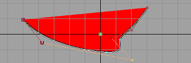

The Interactive check box controls how your shape shows changes when you modify the curve(s).
Interactive off
Modifies only the curve. The shape remains unchanged.
When the mouse button is released, the shape snaps to the new curve. If you do not like the new shape, press +Z (Windows) or +Z (Mac) to undo.
Interactive on
The whole shape updates interactively as you modify the shape’s curves.

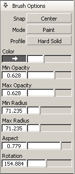

Brush Options
The Brush Options are visible on the Paint Panel when you have a tool from the Paint palette selected, or a tool from the Sketch#2 shelf selected.
This section displays frequently modified attributes of a brush.
When a brush tool is active, the cursor becomes a crosshair with the letter P (for paint) or E (for eraser).
When you hold the cursor over the canvas, the cursor also displays a preview image of how the brush will apply paint to the sketch.
In the Paint Panel or Brush Options box, adjust the Min Radius and Max Radius sliders or enter values in the Min Radius and Max Radius fields. These values are measured in pixels (of the sketch image plane). The maximum brush size is 255. Max Radius is displayed in a solid line and Min Radius is displayed in a dotted line.
Snap
Defines whether the brush follows the center or edge of the curve.
The button in the right-hand side of the Alias main menu bar must be clicked (white) for this feature to work.
Center
Snaps the brush directly onto the curve, so it follows the center of the curve.
Edge
Snaps the brush to the nearest side of the curve. Depending on which edge the brush is nearest to, the brush follows the upper or lower edge of CV.
Brush Mode
Click Mode to select a brush function.
These options control whether the brush will:
Profile

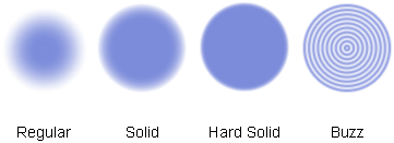

Controls the softness or hardness of the brush stamp edges. Select one of Regular, Solid, Hard Solid, or Buzz from the pop-up menu to obtain the following brush profiles.
To use a brush profile you have customized, select the Custom menu item. Double-click any brush icon in the Sketch#2 shelf to open the brush editor for customization.
Color
Click the color swatch to set the color, or drag the slider to change the brightness of the color.

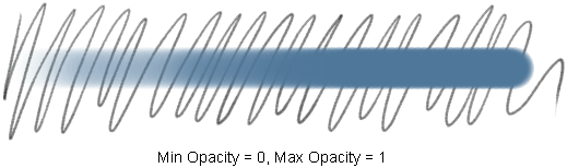

Min and Max Opacity
You can make the brush opacity change based on how hard you press the stylus on your tablet. The Min Opacity is the minimum opacity for the brush (when you press lightly with the stylus) and the Max Opacity is the maximum opacity for the brush (when you press hard with the stylus). If you do not want the opacity to vary with stylus pressure on the tablet, set the Min Opacity and the Max Opacity to the same value.

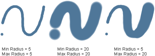

Min and Max Radius
The size of a brush is based on its Min Radius (when you press lightly with the stylus) and its Max Radius (when you press hard with the stylus). If you do not want the size to vary with stylus pressure on the tablet, set the Min Radius and the Max Radius to the same value. Small brushes are more responsive than large brushes.
Aspect and Rotation
Aspect controls how flat or circular the brush stamp is. An aspect ratio of 1 means the brush stamp is circular. The lower the aspect ratio, the flatter the brush stamp. The angle of a flat stamp is based on the brush Rotation.
Rotation is the angle (measured in degrees) of the brush stamp. If Aspect is less than 1, changing Rotation makes the brush stamp more horizontal (0) or more vertical (90). The range is 0 - 360.
Wetness
This slider is only available when the Marker tool is used. Controls the wetness or dryness of the marker. The range is 0 (very dry like a very old marker) to 1 (very wet like a brand new marker).
