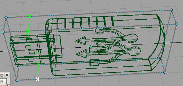

    The toolbox of the Lattice Rig appears, and an initial lattice box is placed around the selected geometry. The lattice starts off being a simple box slightly larger than the target geometry.
    Notice that the edges of the lattice are shown with dashed lines. This shows that it is "disengaged", and changes made to the lattice do not affect the target geometry.
  3. To add detail to the lattice, choose the Split Lattice Edge tool. Place the cursor over an edge, and click a mouse button. A set of green lines appears, which can be repositioned until you select either Accept Split or Cancel. If you are satisfied with the placement of the new edges, click Accept Split.
  4. Repeat until there are sufficient number of points to best approximate the shape of the target geometry. Click Done when you are satisfied with the number of points.

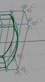

    You have a choice between translating (moving) or scaling the points.
  5. Click-drag a box around a group of points to select them, or pick the points one at a time.
    Points turn white when selected. Click Translate to enable the translate manipulators.
    Notice the cones pointing out from the active points. These manipulators show the directions in which you can pull the points.
  6. Pull manipulators and reselect points to shape the lattice to the geometry.

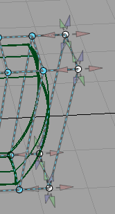

  7. To scale points, click Scale. The manipulators change to the following:
  8. Pull manipulators and select points to scale the lattice.
