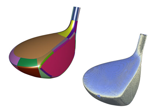

The following example shows a conventional surface layout extracted from STL data for a golf club head. The basic guidelines previously described were used to layout where individual surfaces begin, end and merge.
Some users might suggest trying and develop such an organic shape using one surface, or only a few. This method may work and achieve the same end result. The "surface community" will not consider the model technically correct. The technically correct methods may seem picky or too time-consuming to many users. Over the next few tutorials we will discuss the methods used for the surface boundary construction for the surface model and why it is important to lay out surfaces correctly.

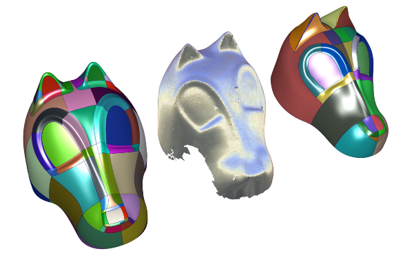

This is another example of surface layout that indicates various users could define a set of surfaces.
The left and right multi-colored surfaces show two different surface layouts. The center is a sky-textured polygonal mesh the structures are based on...
The left example indicates a blend that flows from left to right. The right example indicates a blend that stops and starts in an area divided by another feature (an air intake). Neither example is specifically correct. When possible consult the designer to capture the correct flow of each feature. If the design is yours feel free to define the shapes that are most pleasing to you. Based on experience I would say the left model is correct.

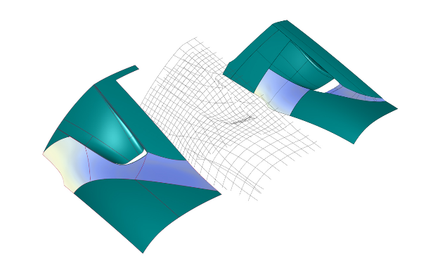

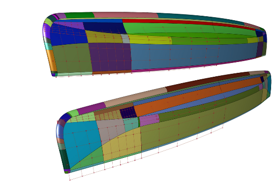

Theoretical intersections are extremely important to surface structure. Here are two examples that show how theoretical intersections can influence the shape of a model.
The top example has a fully defined theoretical, the bottom has a partially defined theoretical. (As shown by the exposed CV's and Hulls) By a partially defined theoretical I mean to say that the wall surfaces do not meet at the theoretical along its entire length. This may allow the fillet to bias itself to one side or the other of the part. This can cause the highlights to sag or constrict in areas that should flow or be consistent.
