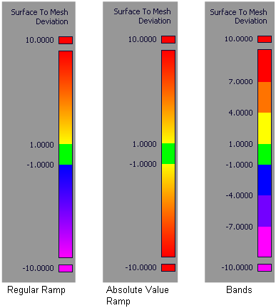

Turn on this option to show the color-coded deviation map.
The color-coded deviation map is only calculated over the selected region(s) on the mesh. The rest of the mesh is shaded in a uniform color.
Maximum distance between source mesh and targets shown on the color ramp. Areas on the source mesh where the deviation is larger than this value are displayed in a solid color (red or purple).
Upper limit for the acceptable deviation between source mesh and target(s). Regions of the source mesh where the deviation is smaller than this value are colored in green.
Where the value of the deviation is between the Acceptable Distance and the Ramp Distance, the surfaces display intermediate colors as shown on the ramp.
The Acceptable Distance also affects the stopping criteria when matching the source mesh to the destination.
The Ramp Distance must be kept larger than the Acceptable Distance.
Turn on this option if you are not concerned with the direction of the deviation and simply want to view absolute deviation values.
Turn on this option if you want the ramp to display solid bands of color instead of slowly varying colors.
