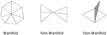

manifold: no vertex is adjacent to more than two boundary edges, and no edge is shared by more than two triangles.

Manifold – Test passes if there are no non-manifold vertices.
