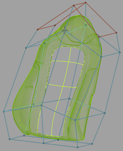

The geometry being modified is represented by a proxy. A proxy is a lightweight wireframe representation of the targets being deformed by an engaged lattice. The proxy interactively updates while you modify the engaged lattice to show what the targets look like after deformation (see the following image). Meanwhile, the targets remain unchanged until you release the mouse button (when Auto Update option is ON) or when you click GO (when Auto Update is OFF).

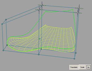

  4. Adjust the lattice box to the shape of your targets by splitting the box (which adds more points) and transforming lattice points using their handles.
  5. When the lattice has the right shape, click the Toggle Lattice Engage State tool. The lattice box changes to solid lines in this mode.
    All modifications made to the engaged lattice influence the shape of the targets enclosed by the lattice.
    All the geometry not enclosed by the lattice are constrained. To show that these areas have been constrained, the lattice points and edges that intersect the geometry are shown in red.

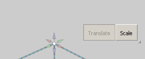

  6. Modify the lattice using the scale and translate manipulators.
