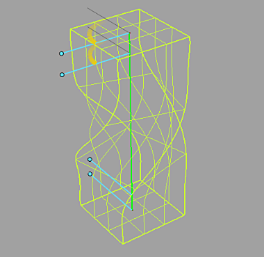

After you have applied the Twist Rig, you will see something like the following screen shot (In this example the target is an elongated cube):
Initially, the Twist Rig inserts four Twist Handles along various points of the axis.
Also, notice that the Twist Rig has highlighted the axis curve in bright green.
Twist handles are visual representations of the Twist Profile, a set of value pairs showing the position and angle of twist, called the Twist Angle. A twist profile can have one or more twist angles. If there is a single twist angle, the twist is equivalent to a rotation about the twist axis.
When a twist handle is selected, it turns white. The angle and position represented by the handle are displayed numerically, as shown in the next image. T90.000 is the angle of rotation for the twist handle, and 0.90 within the red box is the relative position of the handle along the axis curve, which is parameterized from 0 through 1.
