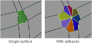

Unequal Radius Corner
Specifies the initial type of geometry to be built at a corner when the radii specified along all three edges are different.
Single Surface – One regular surface.
With Setbacks – Six surfaces, with their edges extending into neighboring fillets.

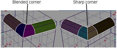

Mitred Corner
Specifies how the outer edges of the two surfaces (away from the zero-radius edge) meet at a mitred corner (see picture below).
Blended – The edges meet in a smooth blended fashion
Sharp – The edges form a sharp corner
Four Sided
Specifies the initial type of geometry to be built at a corner where four edges meet.
With Setbacks – Eight surfaces, with their edges extending into neighboring fillets.
