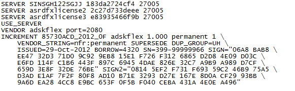

Example of a License File for a Redundant Server
Here is an example of a completed license file for a redundant license server model:
Note:
The redundant server model requires the addition of a port number (the default is 27005) for each server.
