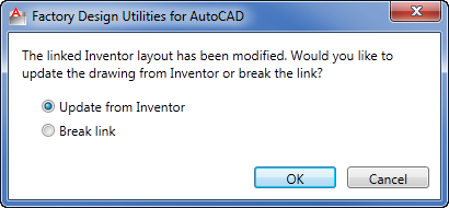

The following dialog box appears when opening an AutoCAD 2D drawing whose linked Inventor Factory layout has been revised. Click OK to update the drawing with the changes from the 3D layout.
