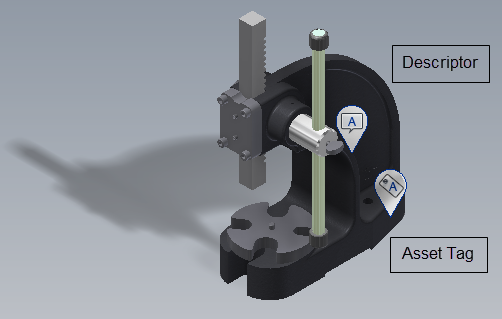

A factory has many pieces of similar equipment, and attaching a description makes it easier to identify a particular asset. Inventor Factory provides the ability to assign such a tag using the Descriptor command. A descriptor can contain additional information about an asset; such as type, part number, flow rate, etc. A descriptor is added when authoring and publishing an asset in the Asset Builder environment. The descriptor is represented with this icon
A published asset can only have one descriptor. If an asset has variants, you can use an iLogic rule to create a descriptor for each variant.

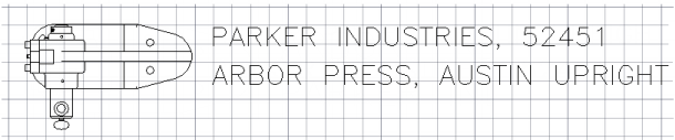

. To learn more, see the Inventor Factory Help topic: Annotations - Asset Tags. Once a 3D layout is synced to AutoCAD Factory, annotations appear as block attributes in a separate text style called Factory_Annotation. The asset tag and descriptor are each assigned their own separate AutoCAD layer. The layer names are Factory_AssetTag and Factory_Descriptor, respectively.
You can use the standard AutoCAD block attribute editing commands like EATTEDIT, -ATTEDIT, and BATTMAN to edit the asset annotations. Control the visibility of the annotations with the ATTDISP command, or by turning layer visibility on/off or freezing the appropriate attribute layer. Use the FIND command to help you locate asset tag and descriptor text in the AutoCAD graphics window.
