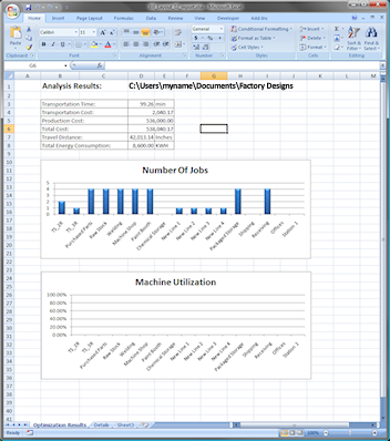

Generating Factory Analysis Reports
You can create a spreadsheet formatted report of an analysis of machine data, including utilization.
  1. Open the DWG layout from which you wish to derive a report.
  2. On the Factory tab > Analysis panel, click the down arrow and select Generate Report from the drop-down menu.
  3. Specify the report filename and click OK.
