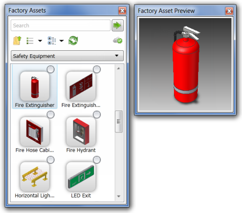

The Assets Browser is made up of the following:
| Search | Enter the name of the asset you are searching for in the Search text box. As you enter characters a list of matching solutions is provided. The more characters you enter, the more refined the list becomes. |
Click this button to begin the search using the search phrase you entered. |
There are two browser view styles - Thumbnail (the default) and Tree. Click the down arrow on the drop-down menu and select your preferred view method. |
Click to display a drop-down menu that provides options to sort assets by asset type, name, or date modified. You can choose to sort assets in either ascending (the default) or descending order. |
Click to refresh the browser contents. |
Indicates the number of defined asset variants. |

| Preview Assets |
 Right-click an asset in the Assets Browser and click Preview from the pop-up context menu to see the asset in an enlarged 3D view. Press and hold the left mouse button as you move your mouse to dynamically rotate the asset in the Preview window. You can also use the scroll wheel on your mouse to dynamically zoom in and out.
