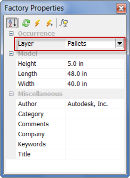

The second method involves the use of the Factory Properties browser.
  1. Select one or more assets from the factory floor layout. Press and hold the Ctrl or Shift keys for multiple selections.
  2. The layer name of the selected asset appears near the top of the Factory Properties browser. If multiple assets on different layers are selected, the layer name appears as *MultiValues*.
  3. Click the down arrow to the right of the layer name to display a drop-down list containing the names of all the layers defined in the current layout.
  4. Select the layer you wish to move the selected asset(s) to.
  5. The drop-down list closes and the layer you selected replaces the previous layer name.
  6. Click the Update button in the Factory Properties toolbar to move the asset(s) to the different layer.
  7. Press the Esc key, or click an empty area inside the graphics window, to turn off the selection highlighting.
