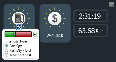

Transportation Indicators
You can adjust the indicator intensity type as well as the information reported on by the indicator.
  1. Transportation Cost = Travel Time x Cost Rate.
  2. Total Cost = Transportation Cost + Machining Cost.
  3. Displays the Total Travel Time.
  4. Displays the Total Travel Distance.
Access the Indicator settings by clicking in the Transportation Cost indicator.
Drag the black separator bar between the red and green fields to modify the sensitivity. Specify the Intensity Type.
Note: The indicator context menu provides access to the variables reported on. Right-click the indicator and use the Indicator flyout to modify which variables contribute.
