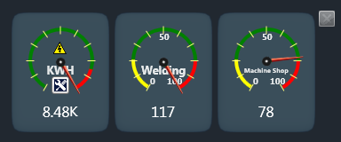

  5. To view the utilization for a specific station, pause the cursor over the station flag. A gauge displays the utilization value for that specific station.
  6. To add a station gauge to the display, right-click the station flag and in Optimization select Add meter to dashboard. You can add multiple gauges to the dashboard.
  7. To remove a gauge from the dashboard, right-click the gauge and in Close Indicator select the name of the gauge to be removed.
