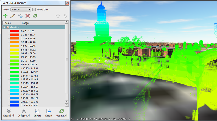

to open the Point Cloud Themes Palette.
(Add a New Theme). A higher number of rules results in a smoother transition between colors.
If you specify the beginning and end colors, InfraWorks 360 creates a color ramp between the first color in the theme (Color From) and the Color To selection. The Preview area displays the color ramp.
The following analysis types are available:
| Normal | The term “normal” refers the direction that a face is pointing, orthogonal to its surface. The direction of the normal indicates the front, or outer surface of the face. Since an individual point cloud “point” doesn’t really have a face, the normal for each point in a point cloud is derived from other points that have a planar relationship with that point (for example, the points in a wall.) The Normal theme shows which points are aligned by displaying colors assigned to the X, Y, Z values associated with the direction of the normal for the point. You cannot specify the colors for this type of theme. |
| Elevation | Themes by height. Minimum and maximum values are determined automatically, based on the point cloud data. You can adjust them if needed. |
| Single Color | If you select Single Color, no further options are available. |
| Classification | Themes by the classification IDs in the point cloud's associated data. This option is available only if the point cloud has been classified. |
