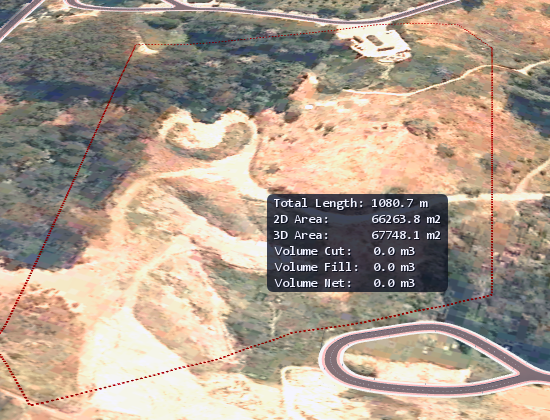

To measure terrain area and volume
  1. Zoom out so you can see the space to measure.
  2. Click .
  3. Click the starting point, and then click the succeeding points that make up the perimeter of the area to measure. Double-click to finish.
    The measurement information appears over the perimeter.
    Volume information appears only if you adjusted the elevation of the measured area, for example, by adding a coverage and adjusting its height.
  4. To clear the current measurement, press Esc.
    The tool is still active, and you can measure another area.
