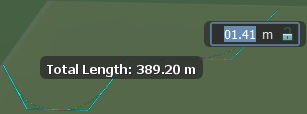

    Define a linear path for the river. Double-click the last point to finish creating the line.
    A linear water feature uses the water style you selected. A buffer surrounds the water on either side.
