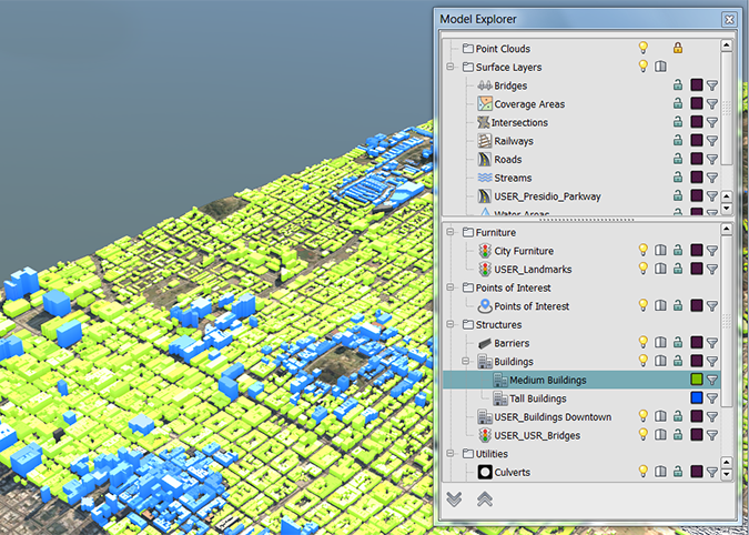

Use subsets to compare data within a feature class. For example, to visually compare buildings of different roof heights, create a subset for each height and assign a different highlight color to each one. Then turn the highlighting on and off for the different subsets to compare their number, location, and so on.
Use expressions to specify a subset of features. A single feature class can have multiple subsets.
Two subsets, highlighted in different colors, showing buildings of different heights
