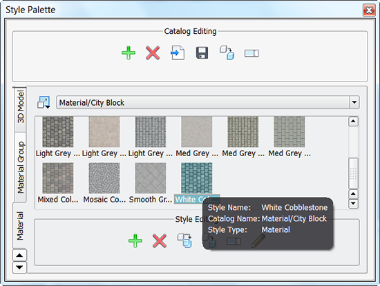

  1. Click .
  2. Click the Material tab on the left side of the Style Palette.
  3. From the style catalog list, select the catalog for the new style.
  4. In the Style Editing area (at the bottom of the palette), click (Add a New Style to the Current Catalog Above).

  8. When you are finished, click OK in the Style Editor.
    The style thumbnail appears in the catalog. Click in the name area to rename it.
