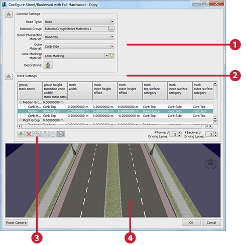

| Setting | Description |
| Road Type |
Select Road, Bridge, or Tunnel. |
| Material Group |
The collection of materials and associated categories that map a material to the different parts of a road style. You can define each component of the material group separately, from within its catalog. See Edit Styles. |
| Road Intersection Material |
Specify the category whose material will be used for areas where road segments cross. When road segments share a crossing region but use different road styles, the road segment with the highest Importance property determines the material for the crossing region. To set this property, display the Propertiespalette for the road segment. Under Transportation, enter a high value for Importance. |
| Lane Markings Material |
Specify a category whose material will be used for lane markings. No lane markings are generated for intersection regions. Turn lane markings on or off using |
| Decorations |
Click |
The rows in the Track Settings table represent elements of the road; the columns represent the attributes of each track. The rows are organized by groups: the right side of the road and the median strip.
By default, the left side of the road mirrors the right side.
(below the table). This adds a new group called Left Group. The new group appears at the top of the table. | Column | Description |
| Group/Track Name | An identifier for this track and its group. The group is either Median, Right, or Left (if you added Left); the track is a component of one of those groups. |
| Group Height Transition Zone Width/Track Main Category | The Group Height Transition Zone Width applies to the group. The Track Main Category is the basic material type for the corresponding road element in the Track Name column. Options in the list are determined by the Material Group you selected in the General Settings area. |
| Track Width | Enter a width for the corresponding road element in the Track Name column. The default unit of measurement is used. |
| Track Inner Height Offset | Enter the beginning height of the corresponding road element in the Track Name column, relative to the previous track in the column. The initial height is based on the center line of the road surface. This allows you to define the road profile as a "stairway" curve for modeling ditches and curbs. |
| Track Outer Height Offset | Enter the ending height of the corresponding road element in the Track Name column, relative to the next track in the column. |
| Track Top Surface Category | Select the material for the top surface of the road. Options in the list are determined by the Default Material Group you selected in the General Settings area. |
| Track Inner Surface Category | Select the material for the vertical geometry that is created if the inner offset height value is greater or less than zero. |
| Track Outer Surface Category | Select the material for the vertical geometry that is created if the outer offset height value is greater or less than zero. |
Changing the number of lanes updates the preview. This is a default value, which is replaced by any actual value for a particular feature when you apply the style.
