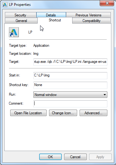

Standard Method
The target line from the language pack deployment shortcut can easily be appended to a deployment script in most network management tools such as Microsoft’s SCCM. This can enable unattended and efficient multi-language Inventor deployments in even the largest enterprise networks
