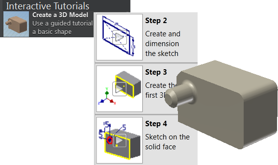

A new basic skills interactive tutorial steps you through the commands and workflows for creating 3D objects in Inventor.

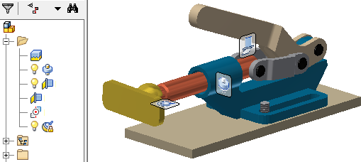

A new tutorial introduces the new assembly Connect command. The tutorial leads you through applying explicitly defined connections to locate components and define motion in one step.
You can create your own interactive tutorials for internal use or to share with others.
Download the instructions and starter files for 64-bit systems here:
http://www.autodesk.com/interactive_tutorial-2014-64bit
Download the instructions and starter files for 32-bit systems here:
The interactive tutorials were previously installed in the Program Files area, which is a restricted access location. The new install location is in a public area. With no administrator rights required, anyone can add new interactive tutorials.
The new location is: <drive>:\Users\Public\Documents\Autodesk\Inventor 2014\Interactive Tutorial\en-US\
The new size, shape, and color of the ribbon command pointer, and the video play button provide greater visibility.
