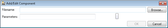

Files to Run
You can specify any number of files to run after your setup is complete. Use these files to do any necessary registration, or any other operations after the files are installed. They execute in the order they are listed in the wizard. Change the order by using the Up/Down buttons.
The executables specified here are not packaged with the install, and they do not install. Instead they are stored in and run from a subdirectory called RunFiles after the setup is complete. These files are in your project location at: {ProjectDirectory}\Output\Setup\RunFiles.
