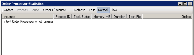

- OrderProcessorStats.exe
- Displays the status of the processing. For each task, shows the memory used, duration, and order count.
Commands are available to pause the processing and update the refresh interval.
