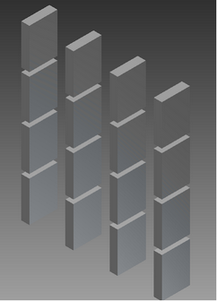

This sample creates a grid of blocks, download it here.
The sample folder includes a complete intent project for Inventor, a task description file (TaskDescription.xml), and a readme file with instructions for running the sample. The sample Intent project creates a grid of blocks. The number of rows and columns is controlled by the Rows and Columns parameters, respectfully. There is a third boolean parameter called Grid? which controls whether the blocks are laid out in a grid pattern or positioned on top of each other at the origin.
