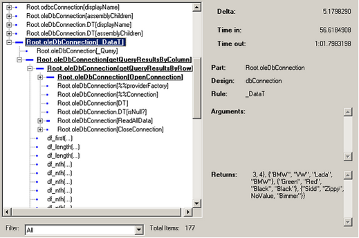

Chronological View Mode of Analysis
The view shows the history of Intent calls. For the particular call, one can see the call duration, the containing part, and so on.
The combo box at the bottom filters out the non essential calls.
The size of the icon on the node shows the relative time that is taken by particular siblings of the tree node.

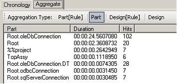

Aggregation View Mode of Analysis
Aggregation View explores the metrics (total time spent and number of hits) in the Rule/Part/Design. For example, the following shows the calls to load the Intent Parts.
