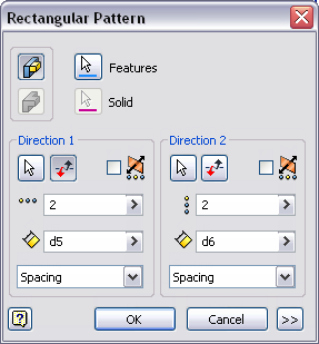

Click
3D Model tab
Pattern panel
Rectangular
. The Features selection arrow is selected. Pick the Hole. If you are viewing the hole in a plan view, it is difficult to select the hole on the part. Rotate the view slightly in 3D before selecting the hole on the part. You can also select the hole directly in the Model browser. Attention: Do NOT select the extruded body, or it will be patterned with the hole.
- Pick the Direction 1 arrow, and then choose a horizontal edge to set the direction. The edge you choose determines the initial direction.
For example, if you choose the lower model or sketch edge, the horizontal pattern direction is to the left. If you choose the upper model or sketch edge, the horizontal pattern direction is to the right.
Use the Flip direction arrow to reverse the direction. Set the count to two, and then highlight the text in the dimension spacing field. With the text highlighted, select the horizontal sketch dimension to use the dimension value for the spacing. Pick the Direction 2 arrow, and then pick a vertical model or sketch edge. Set the count to two, and then highlight the text in the dimension field. Select the vertical reference dimension to use the dimension value.
- Click OK to create the pattern. After you create the pattern, right-click Sketch2 in the Model browser, and turn off the sketch Visibility.
