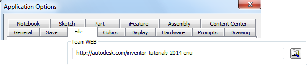

Configure Team Web to launch the default learning resource of your choice
- Access the Application Options dialog box.
- On the Files Tab, specify a Web site or file in the Team Web field. Enter the link to your custom help or, for example, link to the Inventor tutorials on the Wiki.
Test it out

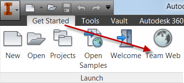

Access Your learning resources
Welcome Screen:
More Learning Resources
Ribbon: Get Started tab Launch panel:
Team Web
Help Menu:
Team Web
In the Application Options dialog box, Files tab, the intranet, internet, or file you specify in the Team Web box displays.
