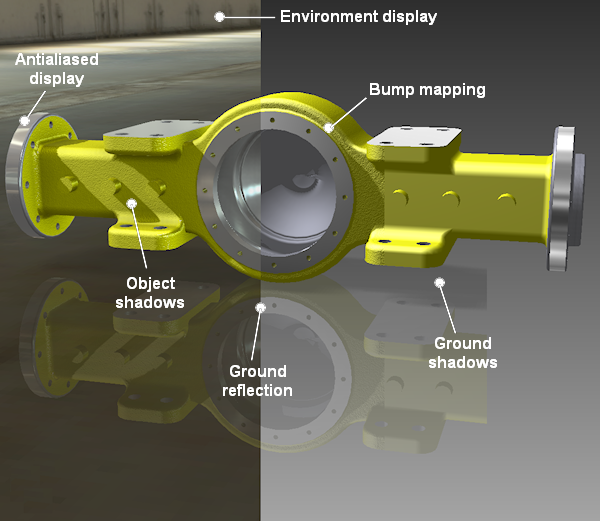

Inventor offers simple, easy to use visualization effects to enable realistic looking models in the viewport. The effects available depend on the capabilities of your graphics hardware, operating system, and the Inventor graphics hardware setting in the Application Options
Hardware tab.
The following illustrates the visual effects you can experience at the various Autodesk Feature Levels, and the table below specifies the minimum system requirements for each level.

You can query your system to find your Autodesk Feature Level in two different ways:
The following table indicates which visual effects are supported by each of the Autodesk feature levels.
| Visual Effect | Advanced 4_1 | Full 3_1 | Medium 3_0 | Basic 2_0 | Legacy |
| Antialiased display (jaggy-free) | X | ||||
| Ambient Shadows | X | X | |||
| Object Shadows | X | X | X | ||
| Realistic Visual Style | X | X | X | ||
| Bump Mapping | X | X | X | ||
| Watercolor Visual Style | X | X | X | ||
| Environment Display | X | X | X | X | |
| Environment Reflections | X | X | X | X | |
| Ground Reflections | X | X | X | X | |
| Ground Shadows | X | X | X | ||
| Illustration Visual Style | X | X | X | X | |
| Monochrome Visual Style | X | X | X | X |
