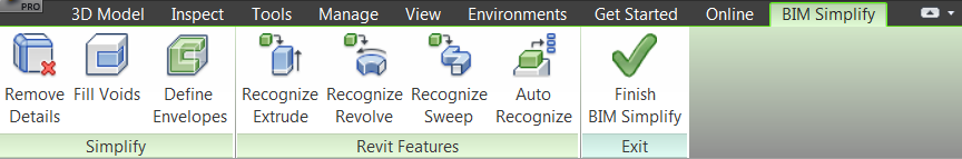

Recognize Revit Features - environment for Part
In the Recognize Revit Features environment, use the commands in the Simplify panel to reduce model complexity. To represent your model with features that can be recognized by Revit, use the Recognize commands in the Revit Feature panel.
Remove Details Simplify a model by removing recognized fillets, chamfers, or custom-selected faces.
Fill Voids: Cap holes and pockets with surface patches that fill model voids.
Define Envelopes Simplify a model by replacing selected components with box/cylindrical envelopes or creating simple extrude features that represent their shape.
Recognize extrude Recognize extrude features, and convert them to extrusions recognized by Revit.
Recognize revolve Recognize revolve features, and convert them to revolutions recognized by Revit.
Recognize sweep Recognize sweep features, and convert them to sweeps recognized by Revit.

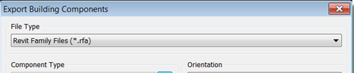

Auto Recognize Automatically recognize extrude and revolve features, and remove fillets and chamfers. A native Revit Family file can be exported using Export Building Components in the BIM Exchange environment for Part documents. In addition, Connectors, Properties, Parameters, Orientation, Category and Insertion Point information can be added to the Revit Family file format.
Before exporting a Revit Family file, Inventor users must prepare the model so that model features can be translated into native Revit form features. In Inventor 2014, extrude, revolve and sweep features can be translated. Inventor users can convert an existing model using the BIM Simplify environment, or they can create a compatible model by using only these three features to construct the model geometry.
