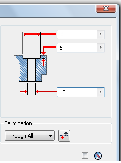

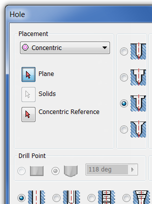

  2. In the Hole dialog box, set the Placement to Concentric and the hole type to Counterbore.
    • Set the counterbore diameter to 26 mm.
    • Set the counterbore depth to 6 mm.
    • Set the drill diameter to 10 mm.
    • Set the Termination to Through All.
  3. Click the Plane selection arrow in the dialog box, and then select the front plane of the revolved shape. The hole is previewed and the select arrow is moved to Concentric Reference.
  4. On the model in the graphics window, choose the edge of the revolved shape to define the concentric edge.
  5. Choose OK to create the hole.

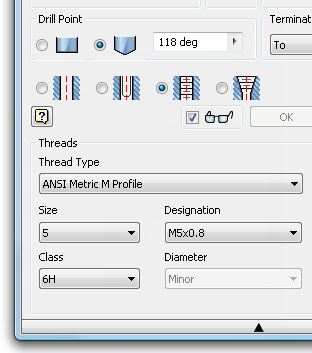

  6. Start the Hole command. Set the Placement to From Sketch, and select the end of the 6-mm line to locate the hole.
  7. In the Hole dialog box.
    • Set Hole Type to Drilled.
    • Set Termination to To.
    • Set Hole to Tapped.
    • Set Thread Type to ANSI Metric M Profile.
    • Set Size to 5.
    • Set Designation to M5 x 0.8.
  8. Select the interior of the counterbored hole on the model to define the To termination, and then click OK to create the hole.
