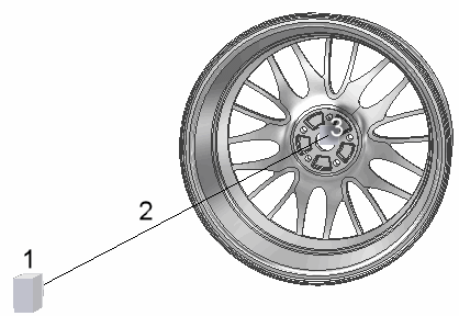

  3. The camera also appears in the graphics window. By default, the line-of-sight vector is normal to the screen. Orbit the model and zoom out to see the camera symbol and vector.
    The camera consists of three parts: the camera, the line-of-sight vector, and the target.
