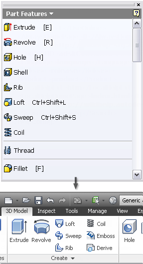

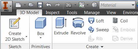

The fundamental characteristic of the new interface is that commands formerly located on panel bars and toolbars are now located on tabs.
Commands formerly found on the various common menus are also located on the tabs.

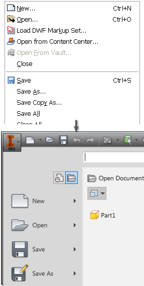

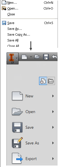

Commands formerly found on the File menu are now located on the Application menu.
