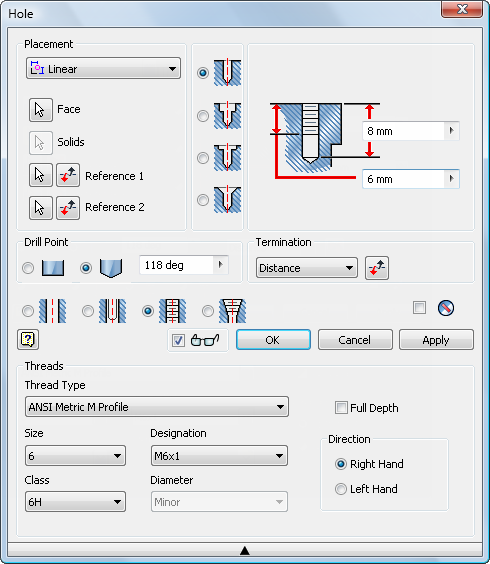

- Using the Hole dialog box, enter the following values to create a M6x1 - 6H metric tapped hole with a thread depth of 6 mm:
| Thread depth |
6 mm
| Drill Point |
118 deg
| Termination |
Distance
| Hole Type |
Threaded
| Thread Type |
ANSI Metric M Profile
| Size |
6
| Designation |
M6x1
| Class |
6H
| Direction |
Right Hand
The Hole dialog box appears as shown in the image.
- Click the OK button to close the dialog box, create the tapped hole, and finish the command.
