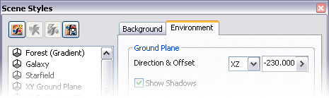

  3. Activate a scene style for the best rendering. Several scene styles are provided and you can create new ones.
    • On the Scene panel, click Scene Styles.
    • In the Scene Styles dialog box, click the New Style command, and name the new style XZ Reflective GP(Tan).
    • On the Environment tab of the dialog box, set Direction & Offset as shown in this image.
    • Configure the other settings to your preference, save your changes, and click Done.
