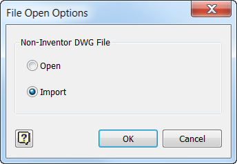

Open and select the appropriate file. If you are importing a DWG file, click Options. Select the Import option and click OK.
Click Open to start the DWG File wizard.

Open and select the file. If you are importing a DWG file, click Options, and select Import options, and click OK. Click Open to start the DWG File wizard.
