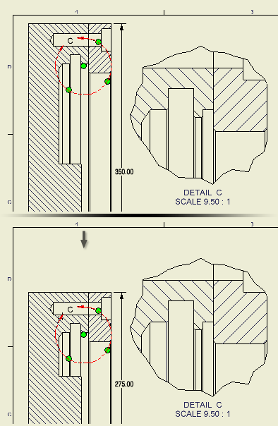

Use the Attach command to associate detail view definitions with the parent view in the drawing environment. If the dimensions or positional relationships of the parent view geometry are altered, the attached view definition remains attached to and moves with the user-specified attachment vertex.
The view definition maintains its relative position to the parent view. A pin symbol appears next to each attached view or symbol in the browser.
In the following image the attached view definition moves with the model geometry when the model geometry is resized.
You can use endpoints, center points, and midpoints for the attachment vertex of the view definition. You can also delete the attachment.
When you copy the parent view and attached view definition to the same sheet, to another sheet, or to a different drawing, the attachment relationship is preserved.
