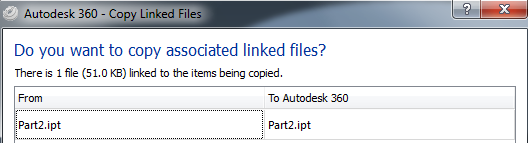

When you save a file to Autodesk 360, the current file is added and all dependant files.
Each time you save a file to Autodesk 360, Autodesk 360 ensures the documents saved locally to your Autodesk 360 drive are in sync with the documents stored in the cloud
You can drag and drop documents to the Autodesk 360 drive from Windows Explorer. Files added to your Autodesk 360 drive from Windows Explorer will automatically upload and sync with your Autodesk 360 account. All referenced files are uploaded during this process.
