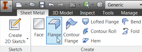

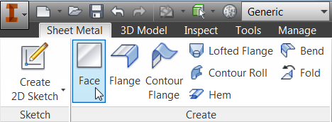

  2. Click the Face command and create a face.
  3. Click the Flange command and add a flange.
