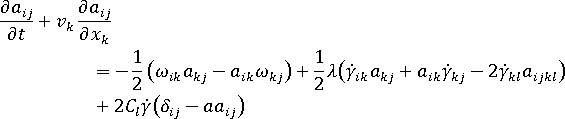

Until now, the Folgar-Tucker model has been the best available for fiber orientation modeling in concentrated suspensions. The model has been given in this form by Advani and Tucker:
where:
equals 3 for 3D and 2 for planar (2D) orientation
is the velocity component
is the vorticity tensor, and
is the deformation rate tensor.
is a constant that depends on the geometry of the particle
is a unit tensor
is the interaction coefficient The tensor form of the fiber orientation model from Advani and Tucker is not yet a suitable derivative for a second order orientation tensor, because it contains the fourth order tensor
The derivative for a fourth order tensor contains a sixth order orientation tensor and so on. The only way to develop a suitable derivative is to approximate the fourth order tensor in terms of a second order tensor.
This approximation is called a "closure approximation". Various approximations have been tested by Advani and Tucker. However, the presence of the approximation itself may introduce some error into the simulation results. So the closure approximation is the most challenging problem associated with this model. No value of
can make the fiber orientation model expression fit all the orientation model components.
