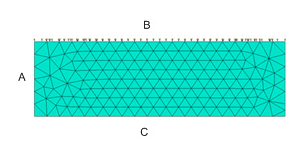

Midplane models
For Midplane analyses, the elements of the model are selected and assigned the property type "compression surface". The nodes associated with these elements are then considered to move with the press plate.

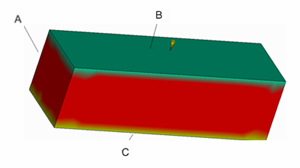

3D models
For 3D analyses, you select the model surface and assign it the property type "Compression element (3D)". Unless you manually intervene, the software will then automatically assign the fixed and moving side based on your analysis setup.

Automatic assignment of model surfaces
Compression surface property result
where A = side surface, B = compression surface, and C = fixed surface
