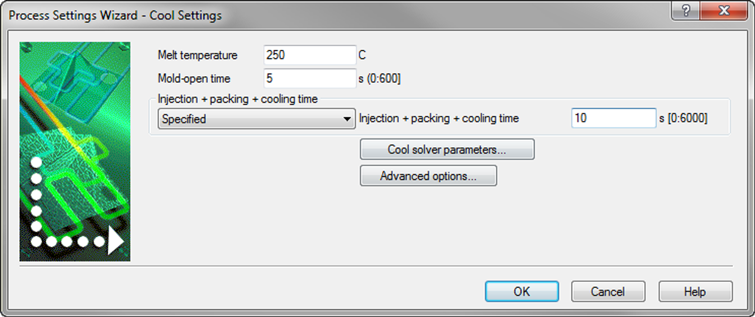

  2. Right click and select Properties.
  3. Set the Coolant inlet temperature to 40° C, and Click OK.
  4. Click (Home tab > Molding Process Setup panel > Process Settings).
  5. Ensure that the Melt temperature is 250° C.
  6. Ensure that the Mold-open time is 5 seconds.
  7. Set the Injection + Packing + Cooling time to 10 seconds.
  8. Click OK.
