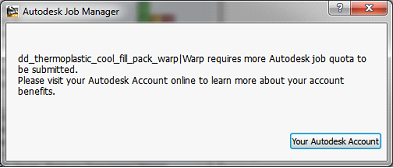

For example, if you send an analysis sequence such as Cool+Fill+Pack+Warp to the Cloud, with only two (2) Jobs left in your account, the first two analyses will run successfully and the third (Warp) will fail with a message similar to the one below.
