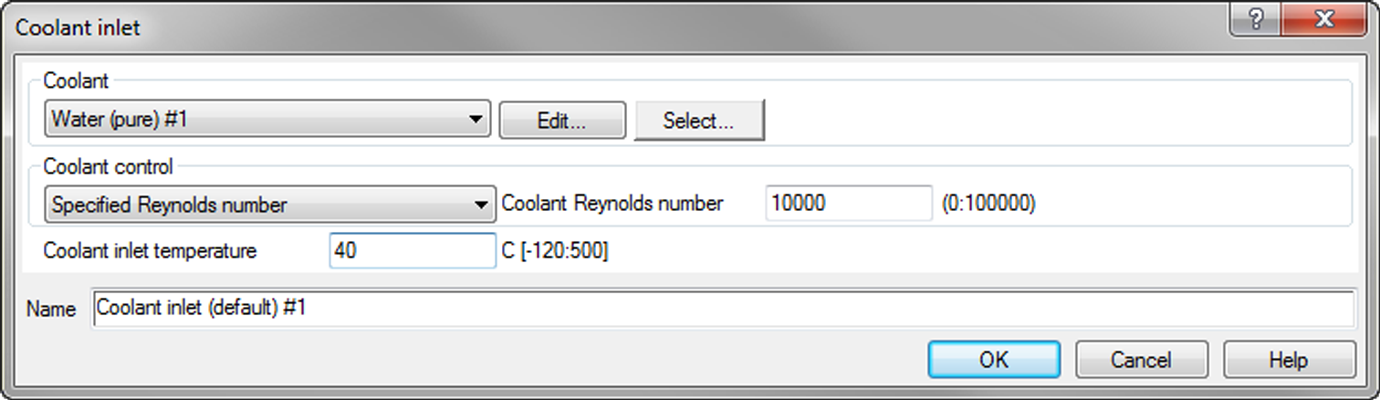

  1. With the Select tool from the Navigation Toolbar, select on of the coolant inlets.
  2. Right click and select Properties.
  3. Set the Coolant inlet temperature to 40° C, and Click OK.

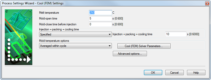

  4. Click (Home > Molding Process Setup > Process Settings).
  5. Ensure that the Melt temperature is 250°C.
  6. Ensure that the Mold-open time is 5 seconds.
  7. Set the Injection + Packing + Cooling time to 10 seconds.
  8. Ensure that the Mold-close time before injection is 0 seconds.
  9. Set the Mold temperature options to Averaged within cycle.
  10. Click OK.
