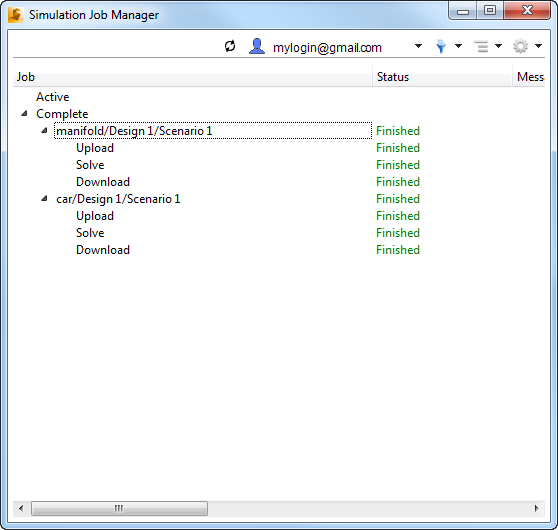

Use the List view to monitor the progress of your jobs throughout the Autodesk® 360 process. The List view informs you of the condition of your jobs, and lets you know when they have successfully completed. If an error occurs that prevents successful completion, the List view lets you know the stage at which the error occurred.
Job
The Job list is a hierarchal list of your jobs. Time-based groups under each product name organize jobs based on whether they are active, recently completed, or were completed for a longer period of time. Each job has several sub-branches that show the status and history of each stage of the simulation process.
Group Branches
Sub-branches below each product organize jobs in chronological order in the following time-based groupings:
- Active: Any job that has an active task.
- Complete: Jobs that ended within the last seven days. (This includes both jobs that ended successfully and those that did not.)
Note: To change the number of days a job is displayed in the Complete group, modify the Number of days to show finished jobs in the General tab of the Preferences dialog box.
Job Branch
Each job is presented as a unique branch. Jobs are broken into three stages, each of which is listed as a sub-branch below the job:
- Upload: The process of compressing and transferring an encrypted copy of the model to the Autodesk® secure storage service.
- Solve: The computational tasks performed by Autodesk® 360. Examples include mesh generation and numerical calculation.
- Download: The process of copying the simulation results data from the Autodesk 360 secure storage service back to the local workstation.
Note: To view the tasks performed in each stage, enable Show Tasks on the General tab of the Preferences dialog box.
Note: When the next stage is started, a notification message appears at one corner of the Windows® Task Bar.
