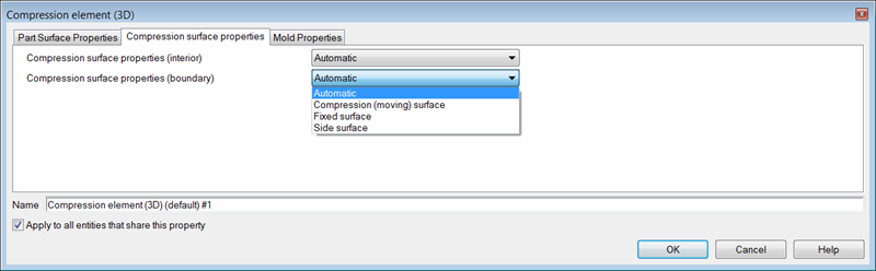

In the example above, there are seven (7) nodes associated with this selection of six (6) elements that we want to assign the compression (moving) surface property. We also want to assign the property 'fixed surface' to the beige elements.
You specifically define only the interior nodes in the compression element (3D) dialog
If you only change the interior setting to reflect the moving surface selection and the fixed surface selection, then nodes B-G, which are on the boundary between the two will be assigned automatically by the software.
You specifically define both the interior and boundary nodes in the compression element (3D) dialog
If you select the red elements above and assign both the interior and boundary nodes the compression (moving) surface property, then nodes A-G will all have that property.
If you select all the beige elements above and assign both the interior and boundary nodes the fixed surface property, then all the beige nodes, and nodes B-G will be assigned the fixed surface property.
Since there is now a conflict between the assignment of those boundary nodes, a priority listing is assigned by the software, in the order:
Compression (moving) surface > Fixed surface > Side surface
