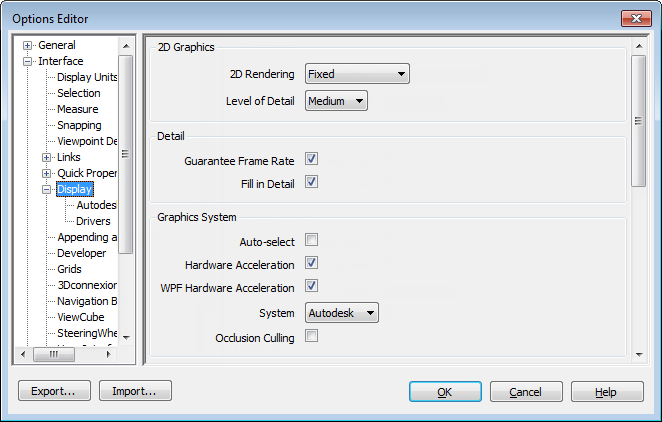

To change graphics system in Options Editor
  1. Click the application button Options.
  2. Expand the Interface node in the Options Editor, and click the Display option.
  3. In the Graphics System area, clear the Auto-Select check box. The System drop-down box is now active.
  4. Use the System drop-down box to choose the graphics system you want Autodesk Navisworks to use.
  5. Click OK. This change will be saved and applied to your future sessions in Autodesk Navisworks.
